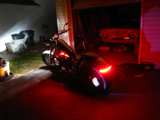

Bill:
Taking the seat and fender off is the best way to modify the rear license plate mount. There is a metal V made out of round bar. I cut mine with a hacksaw. I moved the reflector up and left it on the bike below the brake light.
Attachment 1507
I purchase some self sticking wire clips from the hardware store. I solder longer wires on the the Accutronics red and black to run the wires up into the fender. (right side)
I cut off the existing license plate connector leaving enough wire to solder the extended wires to it. (as to have a disconnect)
I used the self sticking plastic wire clips to the bottom of the rear swing arm. I use a package of shrink wrap tubing and put that over the wires prior to attaching to the clips underneath the swing arm.
I ran my wire in that plastic tubing for hiding wires. It's up to you.
