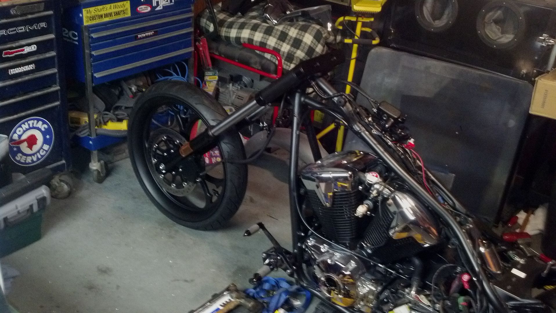

Not the best pic, but this is 10 degree with 2" extenders.

Did you powder coat the Fat Tube covers? And the trees were painted, very cool can't wait to see it at the Demon

Oh shit man that look sick! Very sinister looking.
