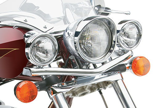

I thought I might pass this on to anyone considering the Cobra Light Bar for the Fury.
It is made of quality materials and has a switch on it to turn the lights off if needed.
FYI:
There is a discrepancy with their instructions on the wiring of it.
They indicate to connect it to the orange with white tracer wire in the headlight bucket.
This wire happens to be the left turn signal running light.
Shouldn't be a problem right, however the front turn signal running lights go out on the 2010 Fury when the blinkers is engaged.
Much to my surprise when making a left turn one evening after installing the light bar the lights went out until I canceled the blinker. funny huh.. I thought so too.
Anyway I ended up wiring it to my aux spoiler LED light circuit which comes on with the key.
I was considering building a diode matrix to connect to the headlight low and high beam. The aux spoiler LED circuit was easier.
I thought I would pass that tidbit on...
