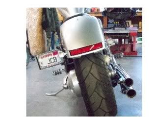

Ill try to get some pics in a bit. I used a finetooth Japanese flush cut saw for the plastic. I cut just above the plate light. For the metal support bar, I used my cut off wheel. I cut the metal tube just above where i was cutting the plastic. I did cover the ends of the metal tube with some extra POR-15 I had in the garage.

If you want to remove the Reflector, license plate light and the Plate mount you gotta use a hacksaw or some other fine tooth saw and when you get to the metal a grinder, dremel, cut off wheel, or hacksaw, then shave the rough edges down with some sand paper or file and paint the cut ends of the metal part.
the wire for the light you need to use for running your plate light which would mean not to cut through it. Everyone on here just followed the line under the tail light where it curls back to the drop down for the reflector

imwright1985, that is a sweet cut on Predator's bike and I saw the Montana redneck thread already....I don't want to have a cut out square hole on the bottom of the plastic and was wondering how you got such a straight cut?

mask it off, leave a little extra lip over the edge of the masking then shave it down with a file or sand paper to edge the lip closer to the masking and have a slight bevel so it isnt a rough edge. just take your time, if you have a flat surface you can use that to make sure the cut is level and shave the extra off to level it better. just remember its easier to take off then put on, so dont go too far in with your cutting

i cut mine around the light like above. then had a body shop fiberglass the cut out and paint it. If i would have known that the plastic piece only cost 14 dollars i would have tried to do it myself and saved a little money. after i cut the under frame i welded a piece of flat bar to make the piece rigid again. it seamed to flex a little before i did that

thanks guys had i known that the plastic part was so cheap i would have tried myself but i guess $100 wasn't too bad for them to fiberglass it, paint it and have it back to me the next day.
