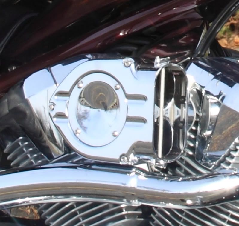

"Here's a close-up of mine if it helps".
Lovely, Saltydog, but what model number is it???

Ya, there's about a million of them on Ebay, for all kinds of different model Harley's, including some for carbs and some for fuel-injected. Nobody seems to know what the difference is. It would be most helpful if L&M could post just which model numbers, of the three basic HyperCharger models, would work with their adapter. I can make the vacuum thingy work, no sweat, I just don't want to have to totally re-machine the HyperCharger to get it to fit.This is the response from Low And Mean on the hypercharger mounting question.
Any HD Hypercharger will work, if you get the Kuryakyn brand they have a vacuum line on the back side that needs to be plugged and our Spike adapter will need a slight cut for clearance, right around the triangle window. It's a small cut and very simple. The function of the Kuryakyn Hypercharger does not work because there's no vacuum line on the Fury intake and to be honest we have test this Hypercharge with no issues.The Kuryakyn Hypercharger it is just for looks. We also offer Hypercharger style if your interested for a fraction of the cost. Here's a screen shot of the ones we can get for you. Let us know if you need any other help.
