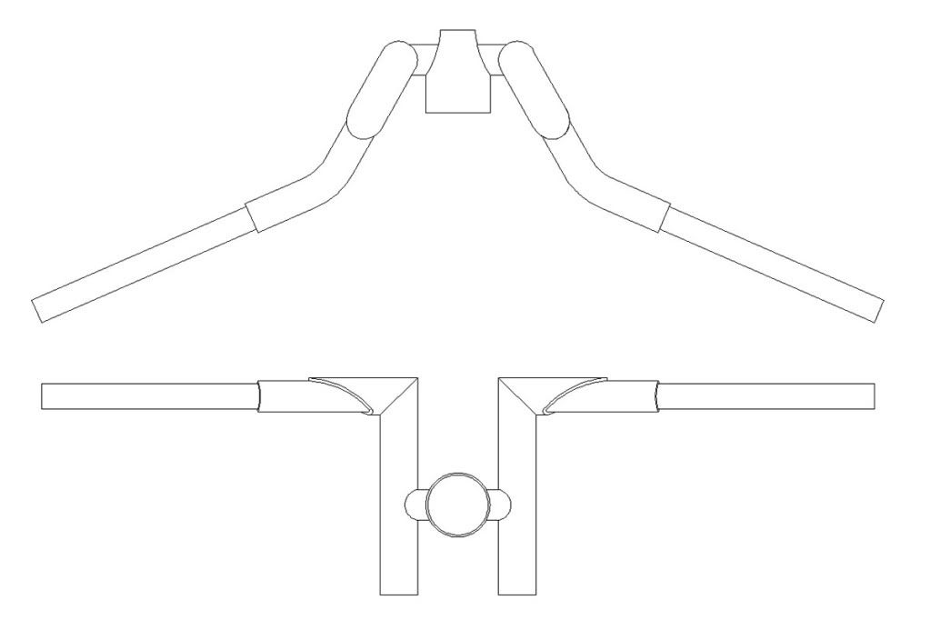

The new speedo has been ordered, Wire Plus T-Bar 2.5" classic black face, chrome body ($229 on special at wire plus, normally $399).
What this means is that the handle bars have been designed and I will be starting work on them this weekend. They won't be ape hangers, they are illegal in Australia, we are only allowed 380mm from the seat to the grips max, I think my 2" risers just about make the originals illegal. Luckily the police here don't have time to read all the ADR regulations so you can push a couple of inches, just so long as your hands are below your ears your probably safe.
I like the feel and position of my original bars with the risers so the new bars will be very similar so as not to lose the original lines to much and grip position. I have taken the risers straight up though to make the front appear longer and have more of a chopper appearance (hopefully). All the wiring will also be internal which will clean it up even more.
The design looks like this, it has 1.5" risers, 1.25" bars & 1" control ends.
So what do you guys all think, not that it matters 'cause they are going on.
Cheers
Guy

Very nice design. The overall appearance looks very cool and something that looks like it belongs on this bike. The speedo is a very nice added touch that fits nicely. Looking forward to viewing your finish project. Nice Job!
Cheers
Guy

Thanks all, looks like they get more approval than the Ape Hangers :).
Fact number one though; the original bars are great, look nice and fit the bike perfectly. There are 3 main reasons I am replacing them:
1. The original bars are in keeping with the original foot pegs, they have been made on a budget, just check the bends. Honda couldn't even bend them with out the shrinking, I hate this and cheap poor workmanship.
2. They cannot be modified to take internal wiring (properly), especially when risers are fitted, if you did manage it they would probably need re-chroming.
3. The speedo (in my humble view) is much too big for a chopper and with the risers is very high. I believe that less is more on this bike or any chopper.
Did I say three, maybe four ...
4. There are now 3 or 4 of these bikes in town and I want to have a bike that is as "individual" as possible, that means the bars must go as they are easy to replace and are a major change to the bike.
I will post more photos as they get built, hopefully get all the steel cut to length today and purchase the 1.5" solid bar to start turning down the ends that go thru the triple trees.
