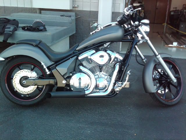

I ended up painting my chrome covers under the seat to match the Matte Silver. I purchased a can of paint through colorite and the match was perfect! After I was done I decided to paint the chrome cover by the shaft black to match the frame. I think it turned out really well and it gives more focus on the V of the engine.
I will give credit where credit is due, as Troy from Accutronix mentioned this to me about 2 months back. I finally had time to get it done :cool:
Enjoy!

Looks good. Did you sand the chrome off first or just primer right over it?
I sanded the chrome down with 800 grit sand paper so the paint will stick. In between coats I sanded 100 grit and then 1500 grit. 4 coats total, 20 minute flash time. No clear coat needed with this paint.
Same process for the black, but I left the orange peel look so the black would blend in with the frame.

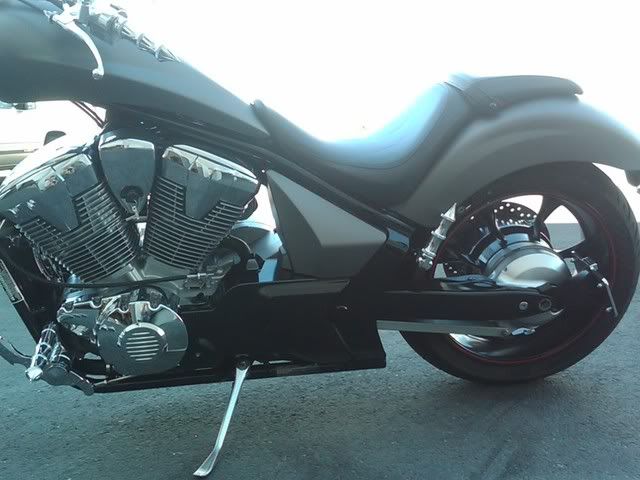

I had the same idea for the chrome covers for mine. I would like to see any other pics of the right side if you have any...

Here are a couple more, I had the intake swapped out :cool:
