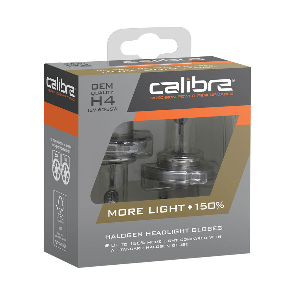

That is why I went with a +150% standard wattage 60/55W H4. Way more light and 15 minutes to install.
These are the ones I use. (But I only buy them when they are on sale for 30 or 40% off)
